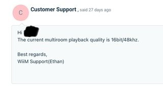

Rather than believe the experienced members of the group, will this screenshot of a ticket I submitted recently convince you?

The image said: “The current multiroom playback quality is 16bit/48khz. Best regards, WiiM Support (Ethan)”
As for the bona fides of members, see the leader board at https://forum.wiimhome.com/members/ and the number of messages shown under their profile in their responses.

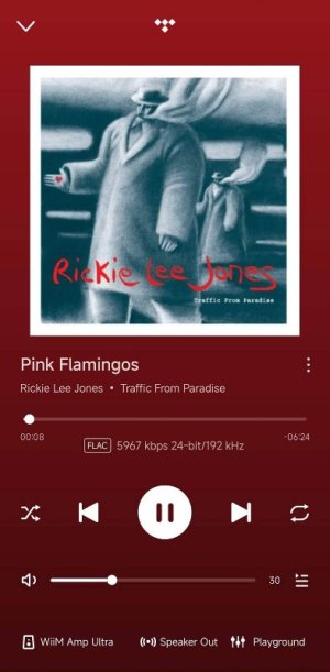

WiiM Amp Ultra as leader, WiiM Amp Pro as follower, since only the Ultra has a screen. As soon as the devices are grouped there are no individual Now Playing screens in the app any more. There's just one unified screen for the group.
Step 1: Playing a Tidal MAX file through the WiiM Amp Ultra. I didn't take pictures of the touchscreen display, but it showed exactly the same data.
Step 2: Group the WiiM Amp Pro with the WiiM Amp Ultra with the Pro becoming the follower. Again, the exactly same data rate was shown on the touchscreen display.
Step 3: Pulling down the Now Playing screen reveals the view on the current album view from the Tidal client integrated into the WiiM Home app. Note that the source is still correctly displayed as MAX while the Now Playing screen displayed the reduced data rate.
This is clear enough for me.
Ok, I see, thank you for the info! Now it is clear !
