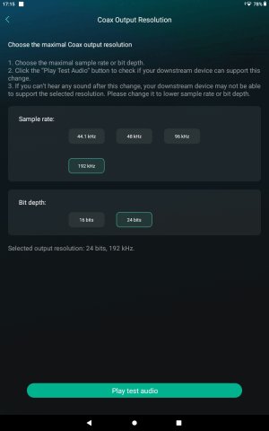

I adjusted the max resolution of the coaxial output to 48mHz and the problem solved. Thanks to everyone suggesting this solution! Much appreciated!
My Wiim Pro Plus is connected to a Denon preamp DAP2500 via a coaxial cable to the digital inputs on the preamp. it plays music via Spotify and Tidal beautifully but only if the resolution is below 48 mHz. As soon as I try to playback music in 96mHz, the preamp goes into standby mode. The display on the preamp changes from 44 or 48 and just blinks. Is my preamp too old? It was made in the years where 48 mHz was the top resolution. I am new at streaming so all constructive advice will be appreciated.
