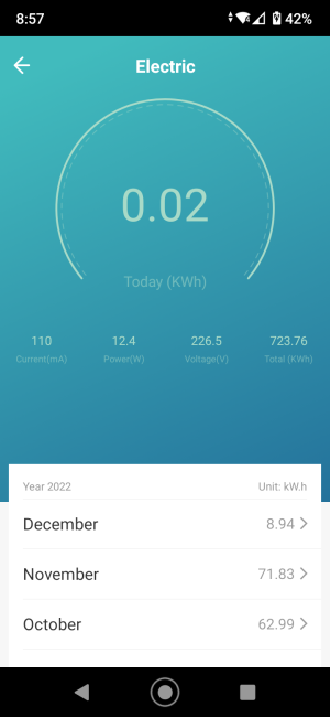

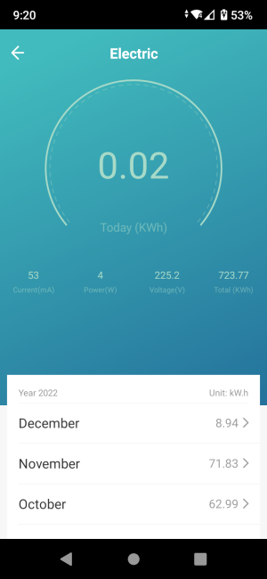

Ignore that power consumption for octomber, November and december, it was connected for deferent device,i just connected now just for mesure the Wiim mini.Wiim mini with full volume in work mode can't detect power consumption,i suppose is less than one watt because some d class amp 50w that i have consumption is 2 or 3 watts, depends of how loud are playing,sonos amp 125w of power usually are about 7w per hour.
