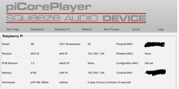

WiiM Pro, Raspberry Pi 4 8GB
And why did I get the 1TB SSD for the Pi when my music library already also resides on the Synology NAS in the background? Partly to show you can host your library internally on a small form factor server alongside LMS, and partly because I could :D

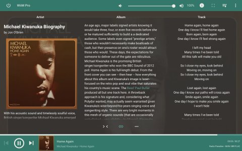

What interface/client are you using in that second picture?
Alright, and then you stream to the WiiM via UPnP?
Yeah, using LMS’s upnpbridge plugin, but hopefully that won’t be for too long as a squeezelite client is on WiiM’s roadmap.
IMHO LMS with the UPnP/DLNA Bridge and Material skin is as good, if not better, than any UPnP server / WiiM combo due to the fact it does not rely on WiiM app in any way. The Material skin gui is a joy to use and if the MAI (Music & Artist Info) plugin is added it then has a lot of Roon like features.

I would appreciate some advice please. I managed to get a Raspberry Pi 4B with the intention of experimenting with LMS by connecting it to my WiiM Mini (I did not like the idea of having to continuously run a fan with the Raspberry Pi 5). I have been able to put it together and have the latest version of Raspberry OS running, however I am struggling from there on. I have entered some of the suggestions on the internet to install LMS through the terminal in RaspOS but it does not seem to be going too well. Also, there does not seem to be much consistency between websites around how this should be done. I realise that I will need to understand how to install a uPNP bridge too because I have a Mini. Does anyone know a reliable source for what I am hoping to achieve?
Once you have LMS up an running on piCorePlayer using its default skin, you should then instal the Material skin plugin and use that going forward to install any other plugins like UPNPBridge
Thank you for the rapid reply. So piCorePlayer needs to be installed on an SD card instead of Raspberry OS? Sorry for the newbie questions.
