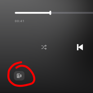

Due to your explanation, my assumption is that you are taking an unnecessary detour and streaming music from your phone to your WiiM device.
If you use the Tidal Connect functionality, you bypass a potential source of interference, e.g., caused by your WiFi network...
Use the highlighted button on the Now Playing screen in Tidal and then select your listed WiiM device. This ensures direct streaming from the Tidal servers to the WiiM device, with your phone acting solely as a remote control.
