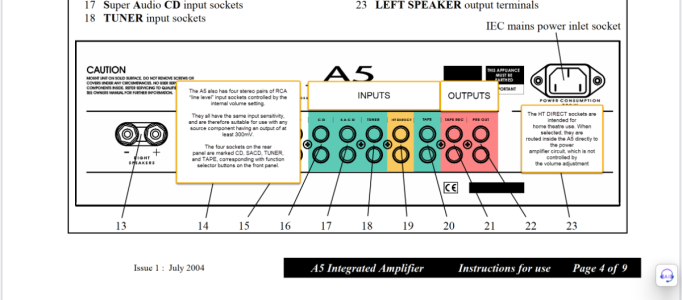

I have a Musical Fidelity A5 Integrated Amp (MFA5)(IA). I'd like to get a Wiim Ultra to use with it. My understanding is that the Ultra can be used with an IA but I'm not certain about the connections.
The MFA5 doesn't have any digital inputs (see attachment). It does have several analog inputs that accept 300 mV inputs so I'm thinking that I would just wire the Ultra line out (LO) (RCA) directly to one of those inputs. According to the documentation the Ultra's LO is rated at 2.1 V RMS (Maximum).
Therefore my confusion. It seems like this arrangement would result in two volume controls. Should I use the Home Theater connection, instead?
I would appreciate it if someone familiar with the line levels, etc. involved could advise.

You can set the maximum line output level with WiiM Home App. For Pro and Pro Plus, it ranges from 200mV to 2V. You can try different levels and select what's appropriate to your integrated amplifier.

Yes, it allows for two volume controls.
The ultra's analog output can also be set from 200mv up to 2v (there are 5 choices).
Probably depends on how you want to control the volume when listening to music - how do you change volume atm? Does the amp have a remote?
You could set the ultra to 100% volume (or any volume, really) and use the amp like 'normal'. This would still allow you to use the ultra's volume control if you wanted to.
If you use the HT input then you will only be able to use the ultra's volume controls, and might need to set some options to limit the maximum volume it outputs.
fwiw, all my wiims are set to variable volume into my integrated amps so that the amp's volume controls the overall maximum and I can control volume from anywhere / everywhere, i.e. phone volume buttons, wiim app, wiim remote, amp remote, amp dial.

Currently, I just use the A5 with its own remote and a CD player as a source. I'm interested in adding a streamer and I like the Ultra but the fact that it acts as a PreAmp complicates things. The other problem is that the A5 has only analog inputs. I was trying to avoid having two PreAmp sections in the same system.
I have read up on the HT option on the Musical Fidelity A5.5 Integrated (a later model) and they added an "AUX" option to the HT input. The information is, typically, not very clear, but it makes it sound like the HT option might not be a good idea. Again, I have to do some reading.
Your solution is probably what I will try - set the Ultra to variable and use the A5's remote to control the volume. I've downloaded the user manual for the Ultra and I will have to read up more. It seems like the more I "know" the more confusing it gets!
