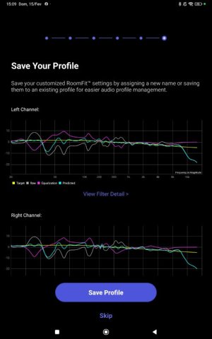

I ended up trying the Roomfit 20Hz to 20kHz, I haven't compared it to Rew yet. For now it'll stay like this, I'll try to improve the frequencies between 40Hz and 50Hz with the subwoofer's position.Screenshot_2026-02-15-15-09-41-240_com.linkplay.wiimhome.jpg

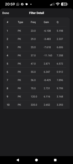

I ended up joining the beta, I tried the synchronization again, this time with the Umik 1 connected to the mobile phone.
I still haven't figured out if the sub synchronization is done with Wiim's microphone (I read that they advise placing the Wiim in the listening location) with the mobile phone's microphone, or if the Umik is recognized as the main microphone.
This time it went to a delay of 81ms.
If you place Umik 1 in another location and measure it to see if the delay changes, you should be able to determine whether Umik 1 is being used for synchronization.
I performed several tests with RoomFit, B&K curve, Pixel 8 pro, UMIK 1 MMM measurement, sub crossover 80hz, 1/12 smooth, 20Hz - 400Hz.
Considering it's a soundbar with a subwoofer, I'm quite satisfied with the results. When I can, I'll compare it to the Rew.

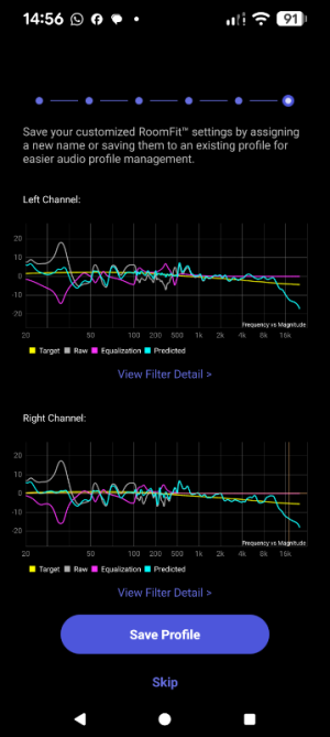

Post 20 when I had the crossover at 200hz, measured without MMM. No boost in equalization.
With MMM measurement, the bass is read very differently...
I changed the crossover to 120hz and increase volume 2db in this new measurement.
I'm tempted to stretch the equalization up to 800hz??

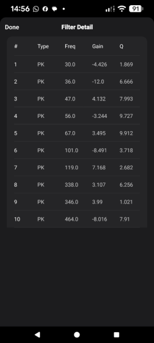

MMM is more susceptible to noise in the room. It should be performed in as quiet a room as possible. Could sounds from appliances like air conditioners or refrigerators be affecting the measurement? When performing RoomFit, you may want to try increasing the volume slightly.
For now, why not create RoomFit profiles with crossover frequencies of 80Hz, 100Hz, and 120Hz as they are, and compare how they sound? Ultimately, choose the profile that sounds best to you. 🙂
