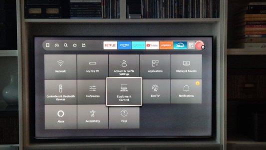

This is the setting under Equipment Control:

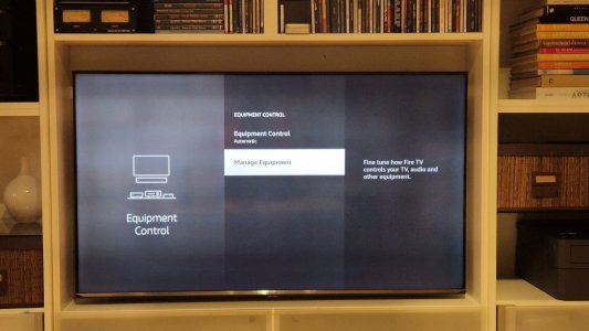

Browse go Manage Equipment

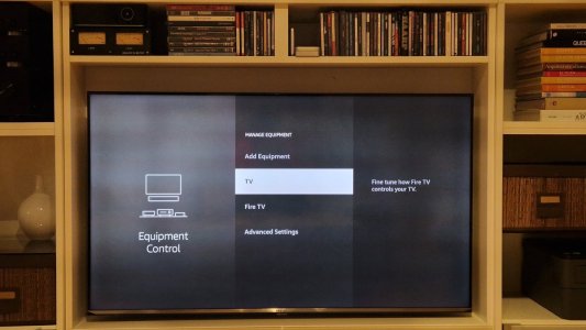

Then to TV

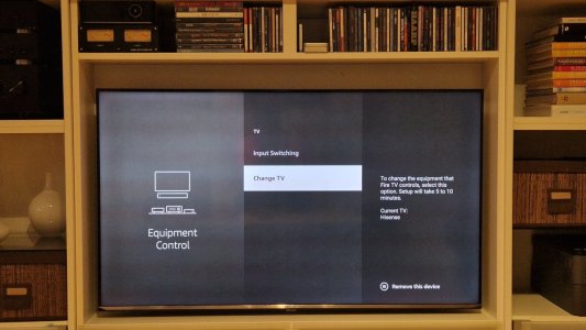

Then all way down to Change tv
and you press the 3 bars button on the firestick remote. Your TV will be removed from the controled devices. So your firestick remote won't switch on or off tv or control volume.
