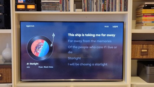

Depending on what TV you have, you can use the WiiM TV App to show album art, etc.

As @hgo58 mentioned, you can also use the WiiM Home TV app on the Fire Stick. In this case, you can control playback using the Amazon Music app on your smartphone and display the currently playing track information on your TV screen. I guess this is probably easier than using the TV remote.

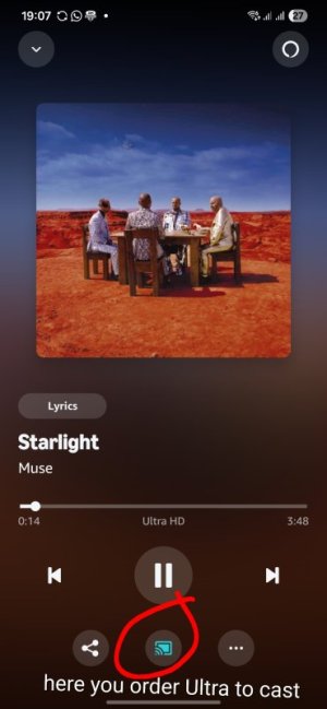

I rather use the app Amazon Music with my phone and enable Alexa Cast through my Ultra.
You'll enjoy the Amazon Music official app while it is Wiim Ultra streaming the audio.

But my advise is to use native Amazon music app on phone and give a try to wiim app on Fire tv. Ultra will stream the song at its original available resolution.
You will no longer needed amazon music app on Fire tv just for the enjoy of lyrics and big album art.

I rather use the app Amazon Music with my phone and enable Alexa Cast through my Ultra. You'd enjoy the Amazon Music official app while it is Wimm Ultra streaming the audio. The other option is to use the wiim home app's amazon music interface (i agree not so nice, many threads here about what lacks and fails).

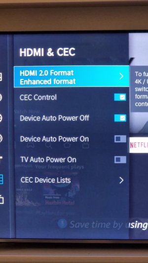

I do have the wiim tv app on my hisense tv so I can use ethernet streaming & have the tv app show me album art, etc. The only issue that I have with this is that I need to keep going into tv setting & turning off cec control because I do have my bluray player, cable tv & firestick plugged into my denon receiver with earc from tv into receiver earc. I also have a qnap NAS but I am not concerned with it as its barely used. Is there a different setup that I should be using?
What is exactly problem with your tv settings and CEC? Why do you need it off?I have it enabled and these settings (I guess menu will be same or very similar in your Hisense)
It works as i want it to. Try out...
