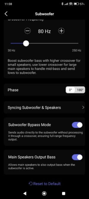

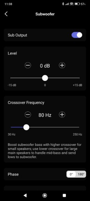

I think we need some more information here. Did you enable the subwoofer output ninnthe WiiM Home app? Can you post a screenshot of the subwoofer settings you use?
What subwoofer make and model are you connecting to your WiiM Ultra?
Triangle Tales 340
When testing (and most probably also for later use) you should disable "Main Speakers Output Bass".
"Subwoofer Bypass Mode" enabled can be helpful during testing, but is usually not the best option for perfect integration between mains and sub.

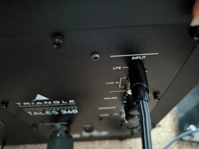

If you disconnect your power amplifier or active speakers, can you hear any output from the subwoofer? Is there some noise or nothing at all? Does turning the subwoofer's volume knob make any difference?
I recommend using the LFE input, not one of the line inputs and setting the crossover frequency knob to maximum, to be on the safe side.

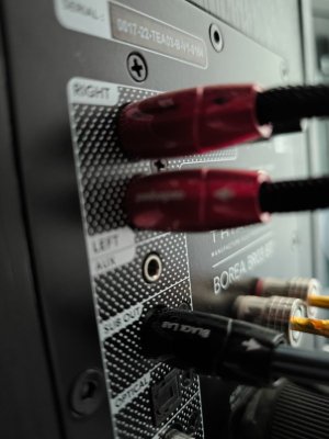

My WiiM isn't outputting any sound to the subwoofer. It was working perfectly fine a few days ago. The active speaker subwoofer works with both outputs. LFE/Line in ok
