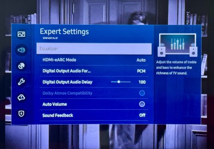

Turn off eARC in the TV's settings screen.

I did as you wrote, and I still have no sound from HDMI.
Have you switched eARC 'off' ?
The manual will tell you how to change it to 'Auto'.

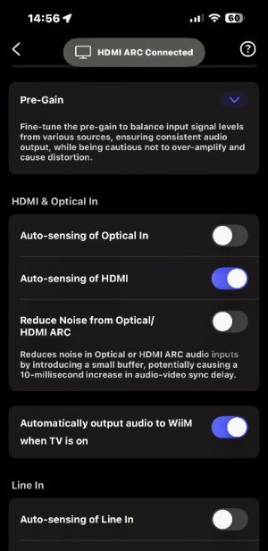

Do you have the WiiM input set to HDMI ARC? I guess you know you can set the WiiM to default to the Samsung HDMI when your television is turned on.
