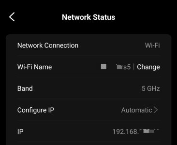

Worst case, you should be able to change the Wi-Fi network any time from within the WiiM Home App (as long as your phone can detect both frequency bands, which most likely is the case) by tapping on "Change":
Pressing the play button on the device for 3 seconds should also start the network recognition process (without the need for an Ethernet connection or resetting the unit completely).
