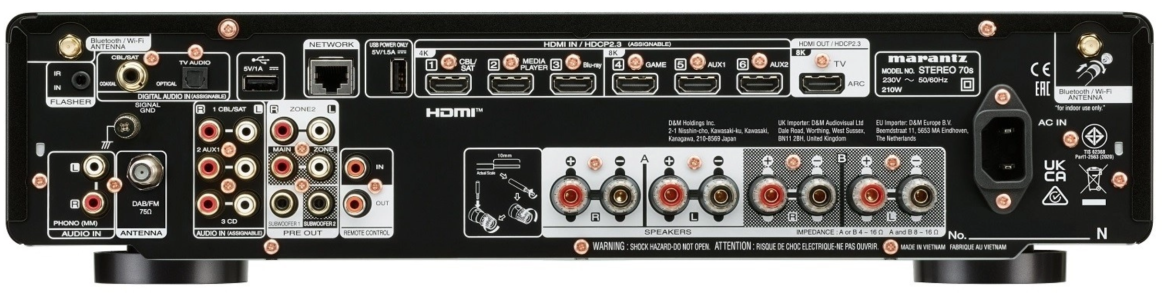

I got the Audiophonics power switch today but unfortunately it won't fit in my receiver, as the receiver surprisingly has only 2 'teeth' (i don't know how you call those) instead of the 3 on the audiophonics. I hadn't even thought of that possibility yet as most power cords i've used have 3. marantz back.png
I know you're not the helpdesk on this :') but are there adapters or an Audiophonics alternative that would make me be able to use the Wiim trigger on this receiver?
I saw Ton Zandbergen's trigger finger but isn't that a DIY solution?
