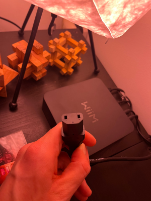

I got the Audiophonics power switch today but unfortunately it won't fit in my receiver, as the receiver surprisingly has only 2 'teeth' (i don't know how you call those) instead of the 3 on the audiophonics. I hadn't even thought of that possibility yet as most power cords i've used have 3. View attachment 4133
I know you're not the helpdesk on this :') but are there adapters or an Audiophonics alternative that would make me be able to use the Wiim trigger on this receiver?

How is your power cord terminated? Would something like this adapter work?

Yes — to clarify what I posted, you WILL also need Ton’s adapter to make the Audiophonics work with the Wiim Pro, due to Wiim’s utter failure to deliver a working trigger feature. I just wanted to post a known-working setup, however convoluted, given official information on this is non-existent.
But it’s very straightforward to put the adapter in ahead of the trigger cable, and the DIY part is all low voltage so there’s nothing risky going on.
