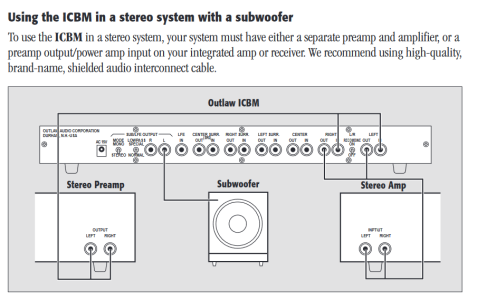

Stereo pre amp, pre outs into a Outlaw ICBM-1 analogue bass mangement high pass device
outlaw into Stereo power amp
bridge link from first amp to stereo power amp
Outlaw sub out into sub
So my speakers are high passed at >60hz, subwoofer receives <60hz.

Nah that wouldn't work. You have a few options
1) Change the Audiolab to a AVR
2) Change the Audiolab to a AV pre amp and power amp combo
3) Get a subwoofer with high level, high pass, put that inbetween your audiolab and speakers
4) Get a subwoofer with low level, high pass, put that inbetween your audiolab and a stereo power amplifer
5) Get a outlaw icbm-1, put that between your audiolab pre out and a stereo power amp
6) Change your Audiolab to a stereo integrated amp with high pass functions. Some Emotiva, Outlaw and Parasounds have this feature.
I did number 5 myself, except with 8000Q and two PX's, so high passing my speakers and vertically biamping
