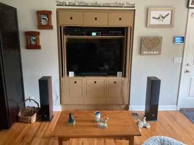

IMG_0631.jpegConsidering adding sub to setup. Current system
Yamaha Rn803
Wiim Ultra
Dali Oberon 5 speakers
I know basically nothing about subs but have started reading up on them. Would like to keep under $500, would not rule out used
Considering something like
Audio engine S6
Klipsch 120SW
Polk Monitor XT-12
Any other suggestions
Just starting this process so at this point looking for some helpful direction.
Only use to listen to music, not connected to TV at this point. 60s 70s Rock, country when mood strikes Pic of current listening location above

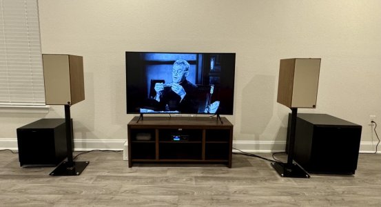

I have 2x SVS SB-1000 Pro and I am pretty satisfied. But I am not sure if they are powerful enough for watching movies. Depends on your demanded soundlevel. The Pro is that the sub is that small. And if you do not need the Bluetooth capabilities the Classic would be enough.
But - two SW are always better (room modes). In my opinion..
BR
Indeed. Two subs will result in more max SPL, and with some optimization can result in a smoother response across a wider listening area.
For a single seat (and not very high SPLs) one sub with some EQ can work very well, however!
