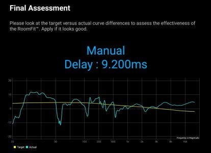

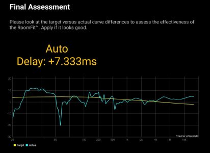

So, I showed Gemini the test results from earlier and asked it to verify them. 🙂
To improve the accuracy of the verification, I added some audio-related materials to Notebook LM as part of my preliminary preparations. I must apologize to @dominikz, but I also used the URL from your excellent post. Here are the results of my query in the Gemini notebook.
To cut to the chase, it appears that the latency correction provided by WiiM calibration is quite reasonable and accurate. However, since there is no data such as impulse response, its reliability remains unclear.

Hmm what did it say about the 39ms delay with the official firmware? It also seems happy with the 14dB reduction in level 😂

Thanks for sharing your detailed test results!

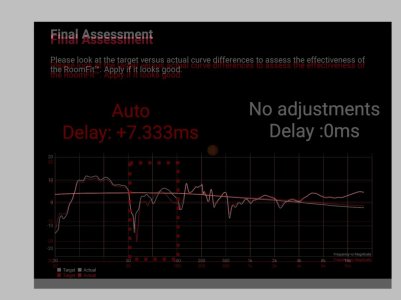

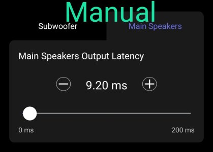

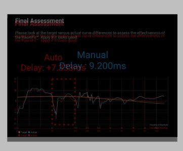

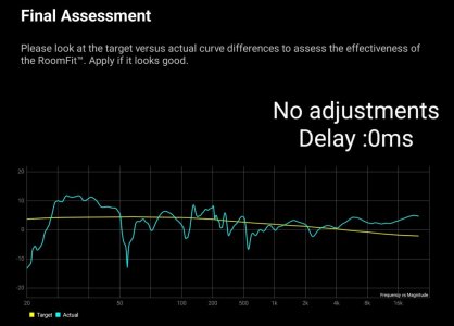

Let me start with a note that IMHO this is not (yet) the type of task LLM-based AI can do well. E.g. here it is making some assumptions about the processing delay of the sub which we can't really confirm from the data available. Today's AI is really good with heuristics (so incredibly good at certain tasks), but doesn't really have any subject understanding or real ability for deep reasoning.

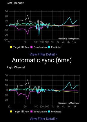

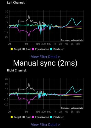

It seems to me that WiiM delay estimate is pretty close now that it is using the external mic, but I'm not convinced that it is perfect. I don't have the beta FW, so my experience is with the WiiM Amp Ultra latest FW:
As you can see, in my system WiiM estimates 6ms delay with 80Hz crossover, but I get a healthier response with more output around the crossover with a manual 2ms delay setting instead. My sub should be fully analogue (SVS SB-1000 Classic) so the 2ms latency should be correct, as it compensates for the physical distance difference.
The auto-gain adjustment also looks debatable to me. If there was no RoomFit it might make sense to reduce subwoofer level as much as the new function proposes. But with RoomFit in the picture, reducing subwoofer level this much is just eating up usable headroom.
@WiiM Team Can you provide some information on what mechanism are you using to calculate delays and gain? Thanks!

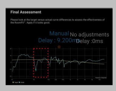

Thank you.

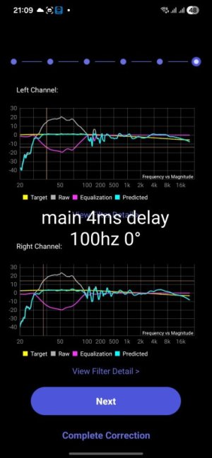

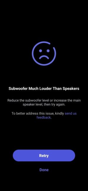

As for delay correction, I don’t really have anything to say about it. I haven’t verified it with my own ears yet. The beta version might offer more accurate correction, but I don’t know how to check.
(Since I don’t usually connect a sub to the Ultra, I connected it from the next room.)
As for volume adjustment, I thought it might be better to change the starting point for correction from the sub’s maximum volume to the minimum volume, or at least the midpoint.
