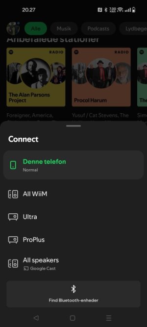

For Spotify Connect I see no text below the device name and for GoogleCast the text Google Cast appears below the device name.

After testing all weekend this does indeed seem to be the workaround. I activated GoogleCast on both my AMPs then disabled and it seems to be working consistently. It sucks that we have to activate it all though. I'd much rather have it not announce itself as a GoogleCast device if it isn't activated.
I have google cast services enabled and in Spotify I can use Connect on Wiim devices.
