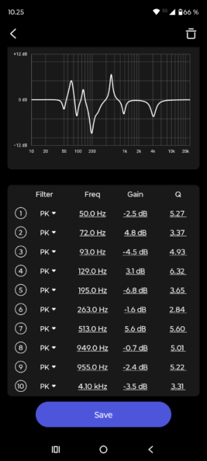

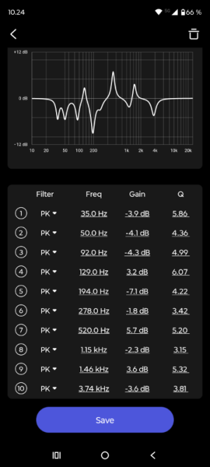

Is it possible to make a custom room fit target curve or download additional filters
Can i have 2 or 3 profiles like having flat,harman and B&K roomcorretion profiles i can switch between
How big is the difference between B&K and Harman
why this difference (both BK target curve) why the diffrence in the midrange ?
With sub (down to 20hz) No sub (only down to 30hz)
View attachment 26629View attachment 26628
RoomFit has only 10-bands of PEQ per channel, and each PEQ filter is limited to +/-12dB gain. This means that RoomFit cannot fix *every* irregularity in the measured response, and therefore it has to prioritize some corrections over others.
Therefore if you change the range for correction (20Hz vs 30Hz bottom limit), or change the response shape somewhere (like how bass response changes when you remove the sub) the RoomFit filter assignments will change accordingly as well.
We don't have any details of how RoomFit algorithm prioritizes specific response irregularities when assigning PEQ filters, however.
Though in my opinion highest weight must be given to fix irregularities at low frequencies.

Spinorama.org contains anechoic (i.e. just the loudspeaker without any room interference) loudspeaker measurements.
The EQ presets on spinorama.org are intended for use *above* the room transition frequency. This is "loudspeaker response correction".
RoomFit (or any other room correction EQ) should be used *below* the room transition frequency. This is "room correction".
So the two EQ types are intended for completely different purposes - from the quoted post it seems you may have misunderstood this.
If you run RoomFit full range you're effectively trying to make it do both room correction (which it does well) and loudspeaker correction (which it can't do well). The reasons why I've covered in the previous post, but they are covered much better in dr. Toole's book.
Of course anyone is free to use RoomFit however they like, and it is great if you're happy with your results.
My intention is just to clarify the nuances to those who might be interested.
