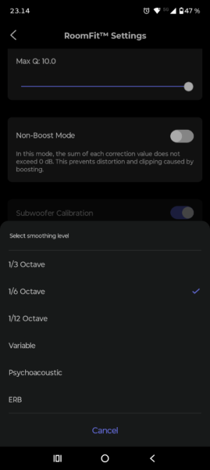

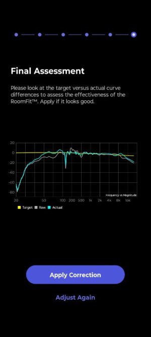

Variable why this drop above 100hz ?
Psychoacoustic
The notch ("drop") above 100Hz is a real acoustic cancellation in your system, and variable smoothing doesn't hide it - which is a good thing. If you know it's there, you can try to fix it by improving speaker placement and/or subwoofer integration.
Psychoacoustic smoothing just hides the response errors visually due to heavier smoothing, but the notch is still there - you just can't see it. It is one of the reasons why psychoacoustic smoothing is not a very good choice for RoomFit.

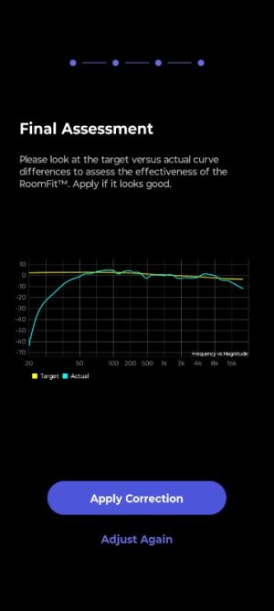

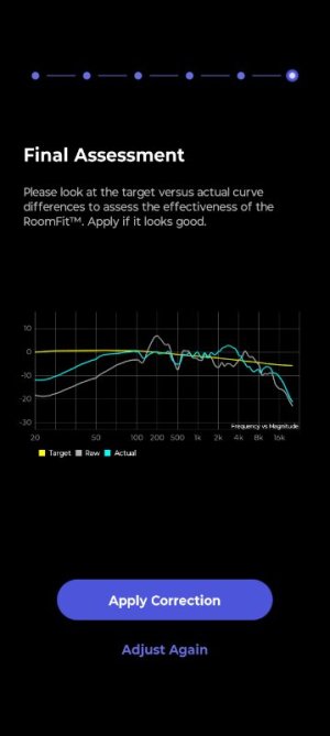

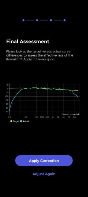

When i measured,did room fit it was reversed when i took a screenshot and had to turn it around before i uploaded it to imgur, mixed it up a few times since i forgot to name the screenshot
Looks like erb is almost like psyhcoacoustics had to delte and re upload many times (re uploaded a new measurement)
1/12 octave also has the 125hz dip
This looks much better, small peaks but down to 36-37 hz -10db with Bk target curve, down to 35hz and psychoacoustics, highs rolling of helps making it less bright,warmer sounding, besides many can't hear 16khz
Have to say you gotta try the new smoothing options
The smoothing option you select can't change your system's low frequency extension.
The only thing it changes is how the curve *looks*, and consequently how sharp the correction filters are. Nothing else.
I settled on psychoacoustics bk 35hz
1/3 octave bk 35hz
