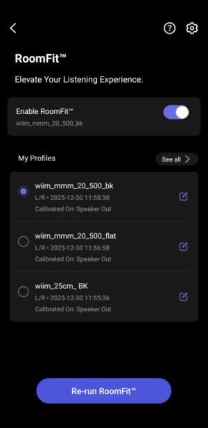

Is it possible to make a custom room fit target curve or download additional filters
Can i have 2 or 3 profiles like having flat,harman and B&K roomcorretion profiles i can switch between
