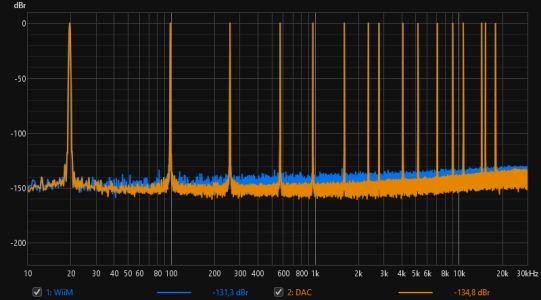

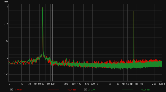

I use a power amp with the fixed level line attenuator connected directly to the DAC and fed from the WiiM Pro. In such scenario I prefer to have my WiiM with fixed volume and to control the volume on the DAC. It's just a personal preference and an assumption that the DAC can apply volume corrections using a wider bit depth and with probably just better algorithms.
A comparison of SMPTE test signal attenuated by 6 dB on the WiiM and on the DAC:
As you can see a difference is barely visible.
That's very helpful thanks. The differenec as you say is very slight. I'll start with using the wiim to control volume purely because I have two way comms with it and can tell where I left the volume. I will use the M500 as a dumb DAC initially and see how it plays out.
