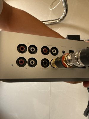

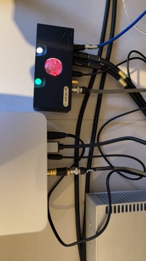

Hi everyone,
I’m having an issue with my Wiim Ultra:
May Setup:
• Streamer: Wiim Ultra
• DAC: Chord Qutest
• Cables: Chord BNC with Cardas (BNC to RCA adapter)
What works:
• Optical out from Wiim Ultra works perfectly with Qutest.
What doesn’t:
• Coaxial out gives no sound at all.
• Qutest shows no input signal (no color change on input button).
• Have double confirmed all software and hardware setup are correct on both Wiim and Qutest

I agree with @EddNog.
However, from the your photo it looks like the Coaxial cable is connected to the phono terminal on the Ultra. (Can't tell from the shot from above...)
Upon closer examination of your photo, I agree--it seems your BNC->RCA cable (presumably that's your coaxial S/PDIF interface) is connected into the wrong place on the back of your WiiM Ultra. Coax output is the RCA connector on the bottom row closest to the 12V trigger out.
You appear to have connected your DAC to the analog subwoofer output (second closest RCA port).
-Ed

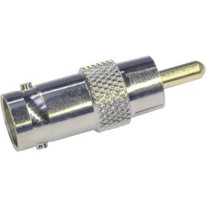

you should especially use a much simpler adapter... here it hardly makes sense and above all it does not guarantee you a good connection as this adapter is so massive...

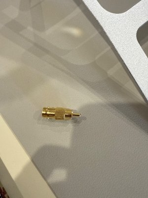

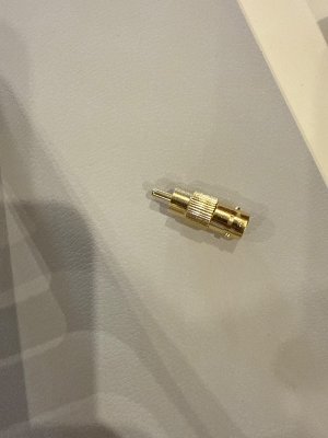

I have tried this simple one. Still doesn’t work.
As checked, the port I connected should be correct.

I would say 2-3months ago, I used the same setup, everything was going perfectly.
As for my home interior renovation, I disassembled my entire system and reassembled it, and that’s when this issue started.
