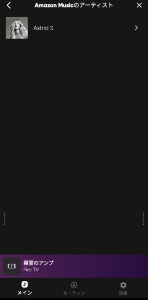

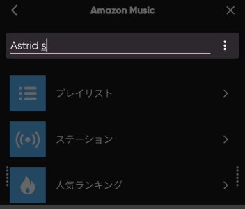

By the way, there was a mysterious discovery. Results vary depending on the search term.
[Ariana] =No search result
[Alaina] =Ok
[Grande] =No
[Glande] =Ok
[Music] =No
[Muzic] =Ok
