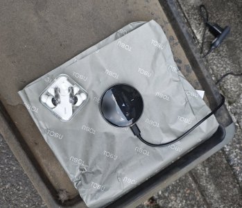

[Test 1] WiiM Mini
The Mini is placed on the road in front of my house.

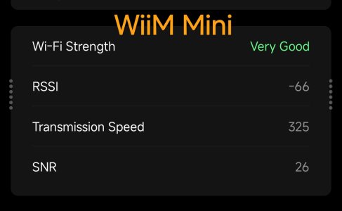

First, I checked the Wi-Fi signal strength.
<Case A>
I connected Bluetooth earbuds to the Mini, put them in my ears, played the test track, and walked away from the Mini to check for any dropouts.
The drop occurred about 10m away from Mini. The further away from this point, the more drops occur. I also noticed that changing the direction of my head made the drops more likely to occur.
At a distance of 30m, the sound became intermittent and almost impossible to reproduce. And then, when I exceeded 40m, communication became impossible.
This shot was taken from a location 30m away from Mini.

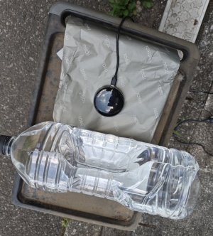

<Case B>
Next, I placed a plastic bottle filled with water in front of the Mini and conducted the same test. This is to confirm any changes in situations where there were obstacles.
I could hear drops about 5m away, and at 10m, the drops were so frequent that it was almost impossible to play.

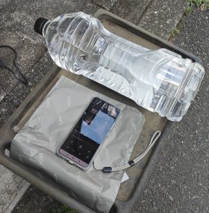

[Test 2] Poco F7 pro
The Wi-Fi sensitivity of the phone is not a problem.
<Case A>
I placed the phone in the same position and conducted the test in the same manner.
Even at a distance of 30m, the sensitivity was good and there were no drops. At 40m, there was a drop, but I was able to continue walking. As long as I stay still and watch the phone, I can listen to music without any problems.
As I approached the 50m mark, the drop increased, but it was still playable. Finally, at the 70m mark, communication became almost impossible.
<Case B>
There were no problems with playback at a distance of 10m, but at around 20m, I began to hear dropouts, and at 30m, communication was almost impossible.

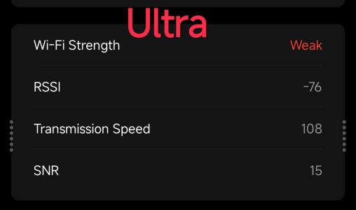

[Test 3] WiiM Ultra
The Ultra's Wi-Fi sensitivity was not good, but testing was feasible.
