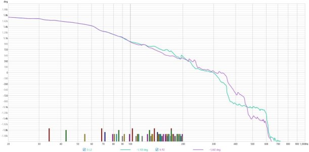

OK so I can see the phase difference between 100-200Hz. How do I find the cause? At first I thought maybe reflections from a TV screen just outside the right speaker but covering the TV with a blanket made no difference at all.This is the REW "Overlays" view, using the "Phase" tab - useful in this instance as it allows you to compare phase responses of multiple measurements.
