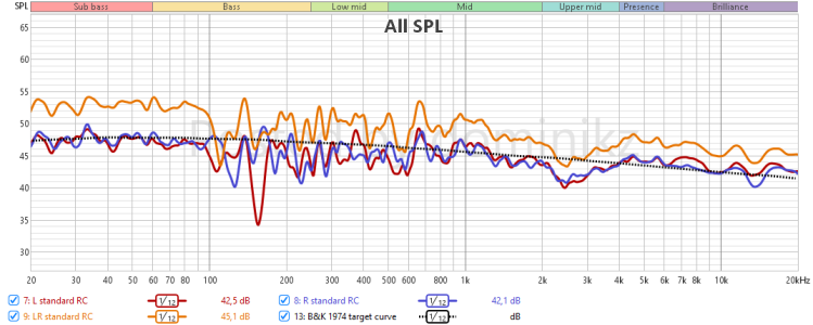

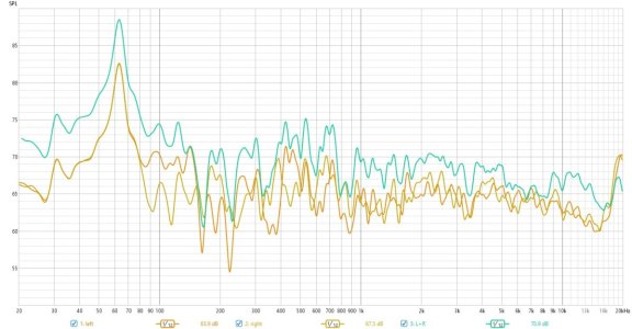

I don't believe the cancelation you are seeing is a necessary byproduct of individual channel room correction.I just tried this again but using unmodified B&K target curve for each speaker and as usual I see a dip in the final stereo result around 150Hz.
If I use stereo room correction then I don't get this dip so is independent channel room correction really a better method?
Maybe left and right channel are somehow not in phase at 150hz and are cancelling each other?I just tried this again but using unmodified B&K target curve for each speaker and as usual I see a dip in the final stereo result around 150Hz.
It is quite a wide dip though.Maybe left and right channel are somehow not in phase at 150hz and are cancelling each other?
You seem to have the opposite, a dip in the left channel which isn't also in the L + R response.I don't believe the cancelation you are seeing is a necessary byproduct of individual channel room correction.

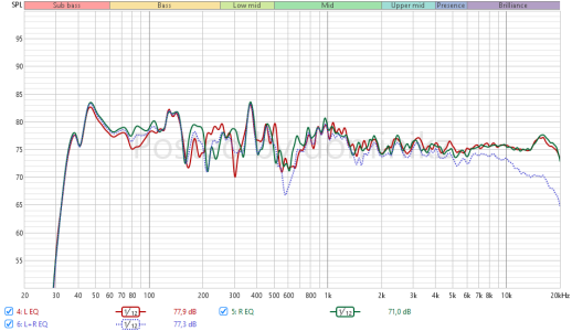

How do your measurements look without any RC/EQ (each channel and both playing together)?

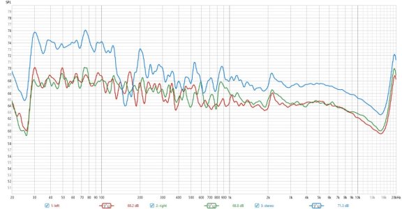

You can see the stereo response with no eq here. There is a dip but not as wide.I don't believe the cancelation you are seeing is a necessary byproduct of individual channel room correction.

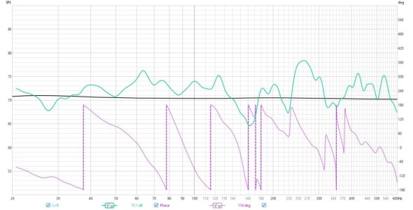

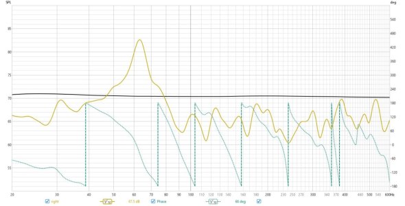

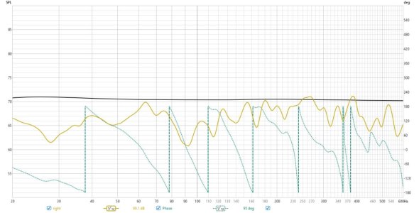

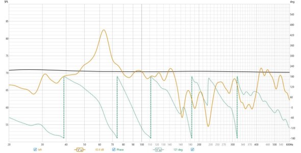

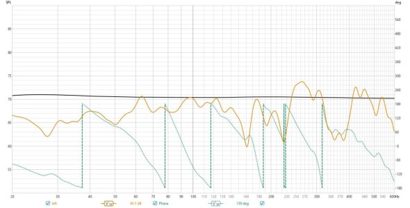

Your speakers are not phase-aligned with each other. That's why you can clearly see the dips when the phases diverge. If this issue is with the speakers themselves, I don't see how you could fix it.I really don't understand phase in REW. If I unwrap phase it varies between 1380 degrees at 20Hz and -1740 degrees at 8kHz. What does that mean?
I am not sure I trust the phase response results. I am playing the measurement sweeps from file rather than generating them directly from REW. That should be OK since they include acoustic timing chirps. If there is a delay affecting single speaker phase results I have no idea where it could be.Your speakers are not phase-aligned with each other. That's why you can clearly see the dips when the phases diverge. If this issue is with the speakers themselves, I don't see how you could fix it.
Are your speakers exactly the same distance from the wall?
And isn't there a delay between the left and right channels in the Wii settings?
There are phase-linear systems - these are the best. But that's not even the point. According to your graph, the phases diverge in certain areas. That's why dips form in the frequency response.I am not sure I trust the phase response results. I am playing the measurement sweeps from file rather than generating them directly from REW. That should be OK since they include acoustic timing chirps. If there is a delay affecting single speaker phase results I have no idea where it could be.

Phase wraps will be introduced by the crossover(s) and by any delays added to the signal (typically caused by digital processing and by the sound propagation in air).I really don't understand phase in REW. If I unwrap phase it varies between 1380 degrees at 20Hz and -1740 degrees at 8kHz. What does that mean?

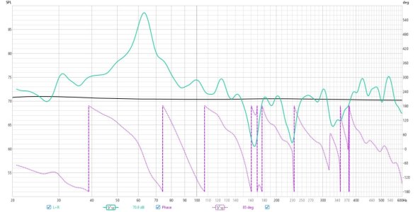

If you are measuring from a file have you made sure that it is always the same channel playing the acoustic timing chirp?I am not sure I trust the phase response results. I am playing the measurement sweeps from file rather than generating them directly from REW. That should be OK since they include acoustic timing chirps. If there is a delay affecting single speaker phase results I have no idea where it could be.
What does a good phase response look like in REW?
The chirp is always in the left channel.Phase wraps will be introduced by the crossover(s) and by any delays added to the signal (typically caused by digital processing and by the sound propagation in air).

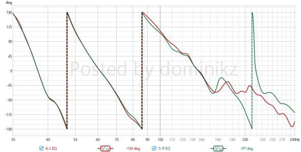

E.g. regardless if you're measuring Left, Right or Left+Right channel the timing signal can always be played by e.g. the Left channel.
This is important because it will reveal any relative delays/phase-mismatches between channels.
There is IMHO no such thing as a "good phase response" shape, but phase response of both channels should ideally track each other as closely as possible.
E.g. this is how the phase plot of my desktop system looks like after EQ:
You can see the phase is pretty close in both channels throughout most of the usable bass range.
The phase wrap at around 215Hz in the right channel seems to be caused by a reflection (I suspect SBIR), and one that results in a distinct null/cancellation in the right channel:
This is the REW "Overlays" view, using the "Phase" tab - useful in this instance as it allows you to compare phase responses of multiple measurements.Which view are you using for the phase plots? I have only seen phase and SPL on the same plot with the phase scale on the right side but you have the scale on the left side.
