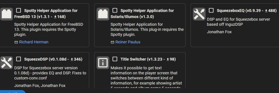

Thank you very much. I found them and activated. But I can't see in my LMS interface.Yes it's a plugin. Look for plugins by jonathan fox.
There are two
peq filters?From what I read EQ functions in lms is still in beta. It loses peq filters

LMS EQ does support PEQ. I think the author is currently in the process of rewriting the SqueezeDSP plugin to include L/R PEQ.Sounds like a smart idea to me.
