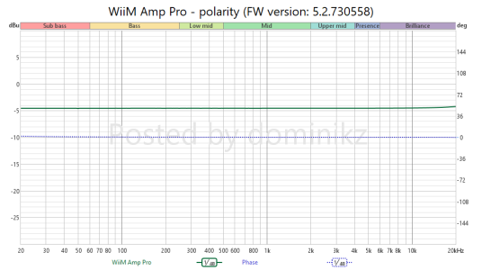

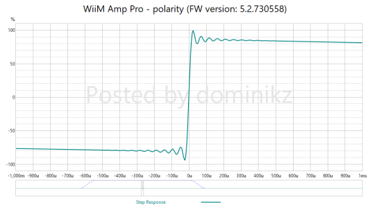

Absolute polarity
As we can see, WiiM Amp Pro inverts polarity at the loudspeaker terminals - I've raised a support ticket to WiiM about this, and they said it is a fault that will be fixed in a FW update.
WiiM Amp Ultra has correct polarity.
Just to report that in current WiiM Amp Pro firmware (version 5.2.730558, build date 2025-09-26) the speaker terminal inverted polarity issue appears to be fixed! :)
