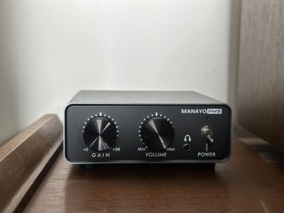

Setup:
Vintage Yamaha YP-D6 TT rca line out >
Manayo PM5 preamp (gain set to max +36db, Volume set to Max) >
rca to WiiM Amp Line Input
Even with the gain and volume maxed out, and the volume adjustment for Line Inout on WiiM set at 100% it’s still probably only about 40-50% of the max volume as playing music from USB drive library of digital files or HDMI input.
I don’t need it to be massively loud, but it seems excessively low WITH a preamp.
Link to preamp:
MANAYO Phono Preamp, Professional Mini Preamp for Turntable/Vinyl Record Player. Stereo Phonograph preamplifier Designed with RCA Input/Output, Headphone Jack, Adjustable Volume and gain https://a.co/d/bhvkRtE
