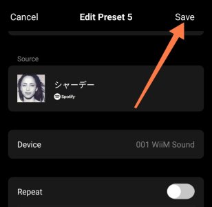

Just to be sure, did you press the save button after changing the values for each item in the Preset edit screen?
Also, if you change the preset name and EQ, you must press the save button on each screen, then press the save button again in the edit screen.
