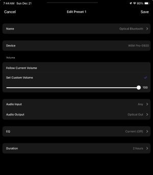

I had originally set the preset’s duration to 4hrs because I only wanted the preset effective for a short time, and then to switch back to the WiiM’s original state… i.e., SPDIF output to coax. I considered that the duration might be “to quit playing”, but “original state” made more sense (to me). The preset attached reflects the duration setting I used for the test. If indeed the duration implies “quit playing” I will create another preset to switch the output to coax, but “original state” still makes more sense (to me)…

Yes, as @hgo58 already mentioned, that is not possible.
Do you want to continue listening to music via coaxial four hours later?
If not, as mentioned earlier, I think you can use the alarm to switch to coaxial at any desired time.

The return to the previous state would be nice but think about what would happen if you activate another (or the same) Preset after the first. In that case the WiiM would need to preserve a history of settings and do rollback. That would be confusing.

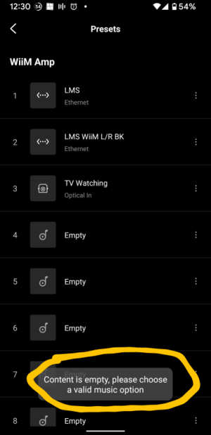

Edit… I see no alarm option to change output settings. I do see where an alarm can run a preset, but if I wanted the alarm to use an existing preset, “switch output to coax”, the list available to the alarm shows that they’re all empty…(?)

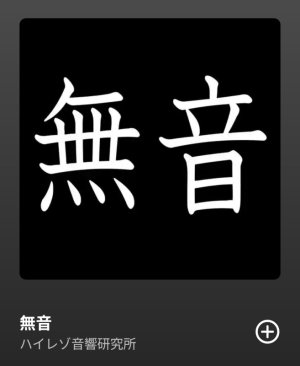

You can't set an empty preset as an alarm. If you use a streaming service, please search for and play a silent track. Searching for "Muon" on Spotify or Amazon Music should yield such tracks.
Play this track and register it as a preset in the WiiM app. (or, you can create a silent track yourself or download one from a website for use.)
Edit the preset and set the output to coaxial. Next, create an alarm and select this preset under 'Music'. Set the Duration to 1 minute and the alarm start time to 1 minute later, then verify it functions correctly.
