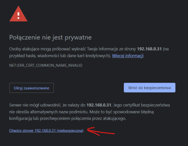

You can use http api for precise volume level management:
https://<wiim_ip>/httpapi.asp?command=setPlayerCmd:vol:90
for 90%.
It does not allow me to enter the link with my wiim’s ip. Certificates are not trusted etc and I cannot access it . Is this at 90% or near if you can try it ?

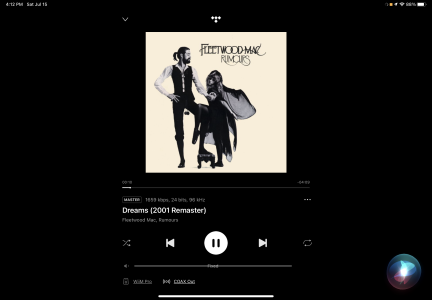

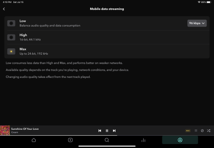

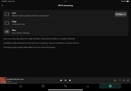

I’m using the Tidal beta but still not getting the 24/196 on theses flac files. Only getting 24/96. I set it to 24/196 maxs but still limited to 24/96. Wondering if any other beta tester are receiving the full 24/196?
Screen shots of tidal setting and of what wiim pro shows at when playing a master file. (Only 24/96)
@Klipscher
Again, and to keep it simple. This Fleetwood Mac album is not available in 192! All hi res streaming versions are offered up to 96.
Even if your stuff is able to reproduce up to 768 it will show 96.
It is a good sign that your DAC shows the correct digits, not that what you want it to show.
