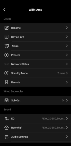

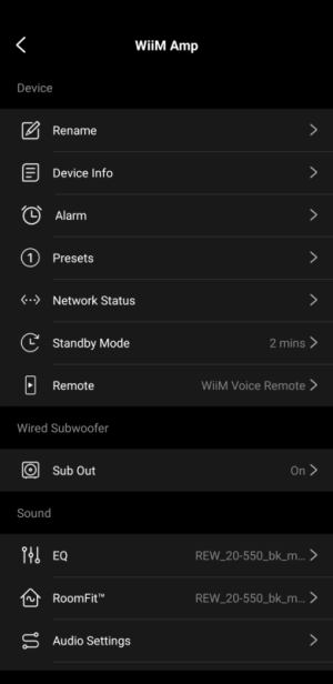

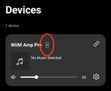

You can tell if the remote is asleep without even pressing any buttons. If you look at device settings there will nothing next to Remote in the list.
If you then press a button on the remote then after about 6 seconds "WiiM Voice Remote" appears.
Some minor trick when the Amp was disconnected from mains: you can push one botton already while the amp is booting up. Thus the remote control connects to the amp during booting already and you can use it from the very first moment, without waiting extra 3-8 seconds.
