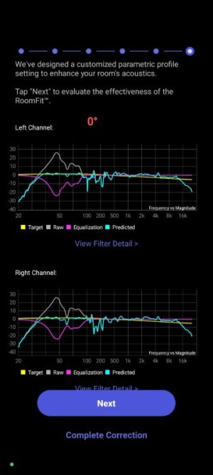

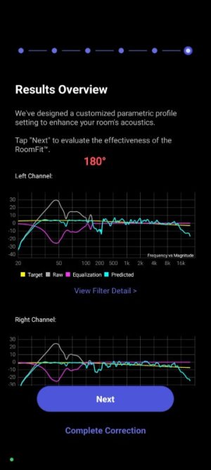

Hey Wiimers, hope you’re all enjoying some great music and occasionally tweaking that curve that gives us all those sweet headaches 😄
I could use some help analyzing and possibly further tuning my system. My setup consists of two bookshelf speakers with active subwoofer. The WiiM Pro is used as a streamer, and both the speakers and the sub are connected to the amplifier via speaker terminals. The subwoofer crossover is set to 55Hz, phase can be switched between 0° and 180°, and the volume is set to about two-thirds.
The speakers are rated down to 40Hz at -3dB, though of course the room likely have some affect. The sub isn’t quite on the same level quality-wise as the rest of the system and only goes down to about 30Hz, but it is what it is.
The sub is positioned next to the right speaker, on the inside, roughly aligned with the front baffle of the speakers. I manually calculated a latency of 8ms. I’ve experimented with different placements, and this is currently the best I can achieve given the room constraints.
I’m attaching screenshots of the same settings, just comparing phase at 0° and 180°.
B&K, 20-300Hz, Non Boost on, .... Which one looks visually better or more “accurate”? Sonically, the 180° setting sounds slightly duller in the high frequencies, while everything else sounds fairly similar.
I prefer a sound that feels open and airy, with solid slam when the track calls for it though I can always fine-tune that a bit further with EQ if needed.

Hello!
Of the two, phase at 0° looks better to me. If you like how it sounds I'd say there's no need to tweak further.
The sub level seems to be set a bit high though, we can see that RoomFit is reducing almost 25dB just below 50Hz.
If you turn the sub off, how does RoomFit look with just the speakers playing?
By the way, how did you come to 8ms latency? That would imply that there's either 8ms of processing happening in the sub, or that the sub is 2,7m further away from the listening position compared to speakers (sound travels around 34cm distance in 1ms) - or a combination of both factors.

Hey dominikz,
Thanks for the reply, funny enough, your posts have actually helped me a lot.
Regarding the sub gain, I also realized I probably pushed it a bit too much. I was just too lazy to lower the gain and run RoomFit again, but if it’s going to improve things, I’ll definitely redo it.
Interestingly, I never ran room correction on the speakers alone without the sub. I used them even before getting the streamer, and the sound was always slightly boomy, I could never get it perfectly dialed in in this apartment. I’ll try that this weekend as well.
As for latency, I took into account the distance from the speakers to my listening position. Since the sub is placed roughly in line with one of the speakers, I calculated it as 2.67 / 0.34 = 7.85ms so it’s basically a combination of both factors.

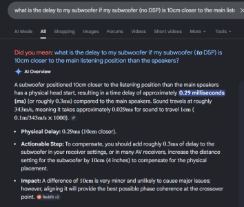

Hate to use AI but I figured it wouldn't hurt to check my math (in my head I know the calc is roughly 1ms per foot, because #merica):
-Ed
