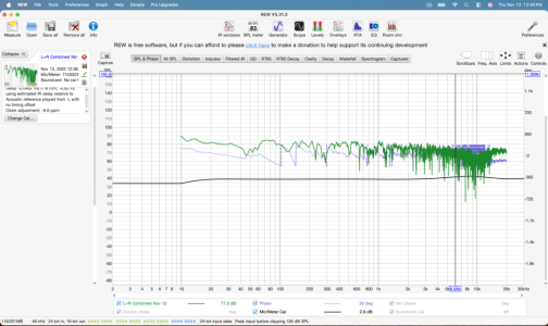

In the image of the status quo,

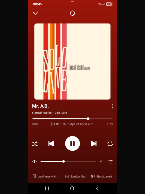

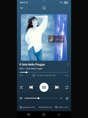

I played two albums:
Solo Live / Nenad Vasilic - Double Bass
and
Alice / Il Sole Nella Pioggia.
While the mono channels on Alice switched off after 30 seconds,
The problem is primarily not the DSP, but the mono output. I assume that, according to the SPL diagram, depending on the music genre, there is little level below 64 Hz, which is not sufficient for the automatic switch-on/switch-off of the mono S.
Setting the sub crossover frequency in mono to < 75 Hz is not effective with these speakers.
In conclusion:

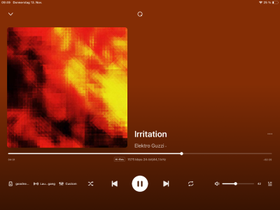

I'm listening to Elektro Guzzi's track Irritation (techno without synthesizer) with only trumpet, guitar, and drums... with the settings as shown in the picture... the bass turned off, but in the next track, it turned back on again.
Within these 3 albums, the volume difference is easily +6dB.

At a distance of 50 cm, the main speaker had to have the same SPL value at 1 kHz for the sine wave and for pink noise at the bass cabinet.

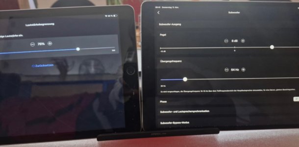

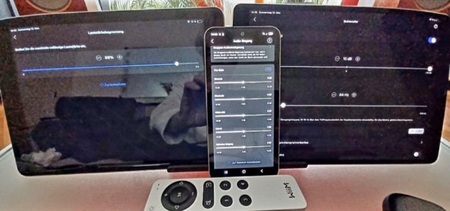

These are the settings
Volume limit = 88%
Sub Out = + 15 %
Pre Gain = 0 dB

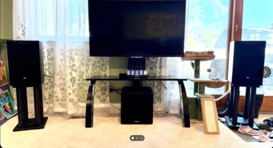

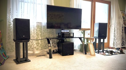

Can I imagine your setup to be something like this, or is this your setup?
This is my setup.
I’ve since removed the laptop as well as the Eversolo. I picked up an eero 6 router on Black Friday sale and am using it as a wireless bridge to the rest of my mesh, and attached the Marantz M1 to the eero 6 router via Ethernet. The M1’s WiFi radio must be trash because the unit kept freezing up and would need to be reboot multiple times a day if I tried to use it as my streamer over WiFi. Ever since I attached it via Ethernet, it has suddenly become 100% reliable. I bought a large MicroSD card and copied my personal library to it, and attached that to the USB port as well, so I am able to stream Qobuz and also listen to my local library via USB. I am in the process of ripping CDs to the attached storage as well so I can listen to stuff from my past and also retire the physical media. Since the M1 is working perfectly now, I was able to give the Eversolo T8 to my dad and take the laptop back for actual daily use and not rely on it for streaming via Audirvāna.

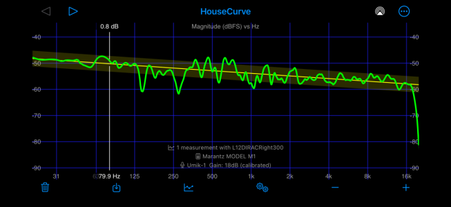

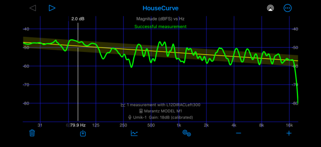

The M1 provides DIRAC Live room correction. It works beautifully (only correcting 12.5-350Hz):
