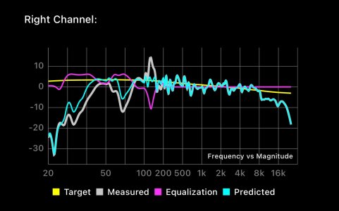

Either approach is OK, your measurements look fine to me!

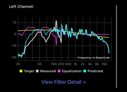

Nice, looks this approach worked OK for you as well! I'd probably just disable the #10 PEQ (538Hz) in the left channel in the profile, I doubt such a high-Q correction is needed this high in frequency.
With this new correction the bass level seems lower and better matches the overall full-range target (and between channels), but the bass response is a bit more uneven than before. This might not really be an audible issue, however.
Do you have any preference between this and the previous correction?
It's hard to describe or tell the difference specifically as they almost sound the same. But what me and my wife noticed is the latter is more pleasant to listen to.

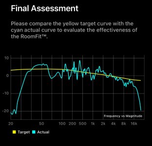

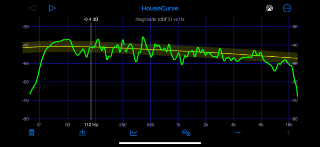

I did several attempts with sub lowered - 9 o’clock.
I used different crossover range 60/80/95 and with speakers latency 0 or calculated by wiim (16 ms)
I guess the best results are with following seetings: latency 0, cross 60hz
What do you think ? I will also experiment with the sound (I mean whether I like the sound or not coz this is why we do it after all, right) coz I am afraid there want be not enough bass with such low sub level.
That doesn't look bad, but ... at one point you the bass extending clearly below 30 Hz, which is no longer the case now. :(
