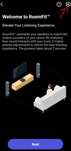

All the RoomFit settings are accessed by clicking the cog in the top right corner of the RoomFit page. You still need a decent microphone though since we don't know how your phone microphone acts at bass frequencies. You have consistently ignored the microphone issue.
Well, I'm curious, can I achieve the same result with Wiim too, but...
I'd like to keep my Wiim Amp Ultra, but I'm wondering how to limit the correction frequency to, say, 30–500 Hz, since the rest doesn't need correction.
How should I proceed? How can I limit the range to 30–500 Hz? Which menu item do I need to use? Can I still use RoomFit to measure and correct speakers afterward?
When running RoomFit you need to keep your microphone at your listening position (where your head is when you listen to music), and pointed between your speakers.
Please remember that the microphone in your phone is not calibrated. This may affect the amount of bass you get at the end. This we can try to take care of in step 4) below with additional EQ.

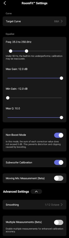

1) Start RoomFit and use the gear icon:
2) Use the following settings as a starting point:
3) Use "Individual Channel RoomFit" when the option is given.

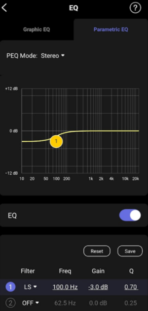

4) If after this you still feel the bass is too strong, go to the EQ menu and configure a single (PEQ Mode: Stereo) PEQ low-shelf (LS) filter with the following settings:
  • Filter=LS
  • Freq=100Hz
  • Gain=according to your preference.
  • Q=0.70
E.g. this one reduces bass level by 3dB (but you can use other gain values if you need more or less bass reduction or boost):

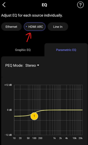

Note that this EQ will only apply for your current input - but you can configure the same for all inputs you use.
  • Filter=LS
  • Freq=100Hz
  • Q=0.70
