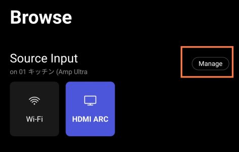

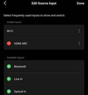

Pressing the Manage button in the input select on the browse screen and hiding unwanted input makes it easier to switch between inputs remotely.
