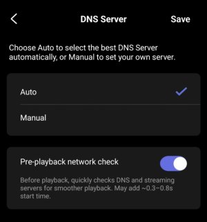

Answer form WiiM:
We are very sorry for the inconvenience.
We recommend turning off the "Preferred DNS Server" function by going to WiiM Home App > Device Settings > Network Status. After disabling this, please restart both your device and router to see if there is any improvement.
Thank you for your patience and understanding.
Answer form WiiM:
Do you know if disabling this should prevent wiim devices from using several DNS servers and pinging to determine which has the lowest RTT? I've disabled, but wiim is still using a few additional DNS servers.
While it started working before changing anything, I usually have NAT rules to rewrite source and destination addresses of DNS queries and replies to avoid devices ignoring my DNS config like this, so sending six queries to the same two DNS servers isn't very useful. I disabled these a week ago when I first noticed the issue, but no improvement. Today, I went to reeable these rules on my firewall and noticed Wiim appears to behave the same regardless of the setting you mentioned being off or on. i guess I could just block icmp too, but I don't want to piss off the Wiim!
