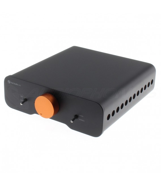

Hi,
A french site where I bought some stuff recently.
They made a great price on it (in amazon.es for instance) and even myself was in the verge to buy a second unit to use as a mono amp to each speaker :) :) :)
