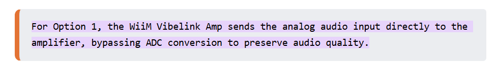

The lower power output has been mentioned by WiiM in this forum and yes, it could also be found in the Vibelink Amp printed manual (at least for the first batch of amplifiers):
The explanation given in the above mentioned edition of WiiM Talks has been - let me put that clearly - rather adding to the confusion.
