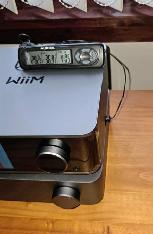

The casing of my Vibelink has so far reached temperatures of 36-37 degrees C after several hours of listening, so it’s not too bad. 🤔
