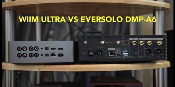

Ultra vs Eversolo A6?
Hi all,
On paper, how would the two compare and which one would be better?
Thoughts?
