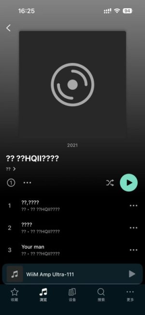

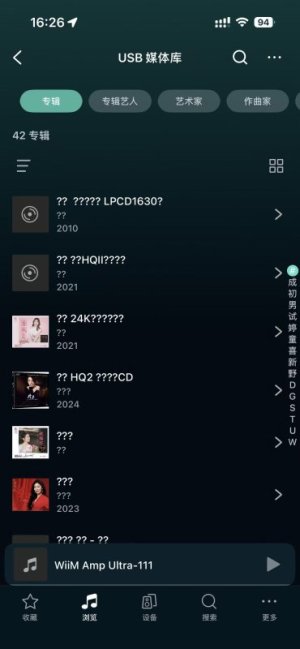

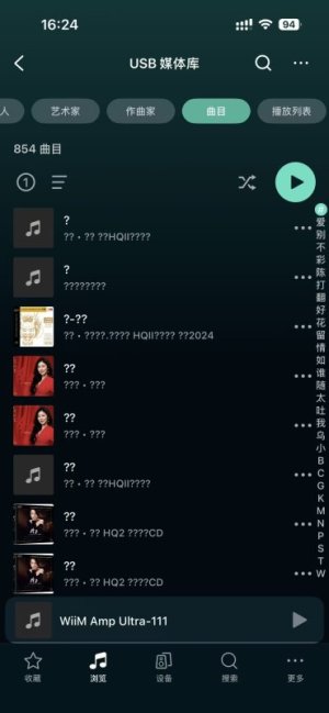

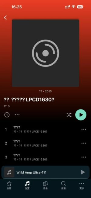

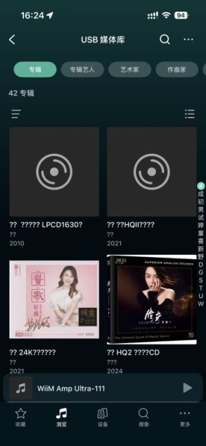

Why is the music file displayed by the application not the song name, but the garbled name when using Wiim Ultra to view the USB song catalogue?
My guess is that the Track title tags are not filled correctly/completely. In this case the WHA will display the file name.
TheThe app displays garbled names, but it can still play normally. app displays garbled names, but it can still play normally.
1da694e0ca079d7c80b433c5e45d423a.jpg11c8729fb3f50e031c9ff010475d8c2a.jpg64f28319379d2cfe696cb6e2149245c0.jpgbc382a0690ff8206c9e2aef6270cba32.jpgf44b0214556259d4f0310fb6964ea0e5.jpg
View attachment 33179View attachment 33180View attachment 33181View attachment 33182View attachment 33183
Please show us your tags as requested by simbun. The above screenshots won't help us in finding the problem.
On the other hand - Are your tags in Chinese? Does the WiiM support Chinese tags? The question marks suggest that this might not be the case.
@Kuakuafu .. do you have any music on your usb tagged in a different language, that way you could compare.
Maybe the issue is related to translation.
Okay, thank you everyone. I'm trying again, thank you for your hard work

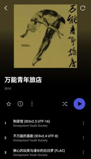

I don't have an indexing WiiM so I tested the open source server (MiniDLNA) upon which WiiM is based with 3 tracks:
Code:
ID3v2.3 UTF-16       01.01.mp3
ID3v2.4 UTF-8        01.02.mp3
FLAC                 01.03.flac
NOTE: I didn't test ID3v2.3 ISO-8859-1 as I know it won't work, and I didn't really need to test FLAC as I believe it's always UTF-8.
These are the common encodings in MP3, though I believe UTF-8 is also possible (supported?) in ID3v2.3.
All 3 tracks were displayed correctly (I think) in the WiiM Home app (WHA), so it seems that support is there, but not for the encoding used in your tracks.
