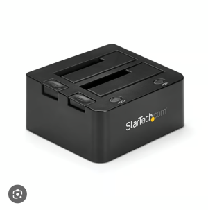

I always use a dockingstation for it.
Can detect ssd,3,5 hdd...i can switch easily between the internal hdd,s.
For instance..
A have another one but i always use a dockingstation.
Have multiple stations.
1 at the pc for instance...you can easily switch between hdd,s where needed.
Supports usb 3.0.
