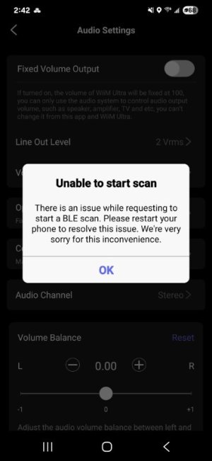

Yes that's true. I saw your pic, with the message. Maybe helpful to fix this issue: It is only to point out that the S22 is also known for Bluetooth problems and your described problems of the phone could be fixed.

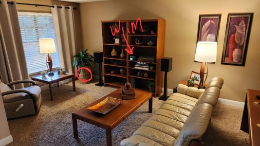

I think it's admirable what a handstand you're doing, including rearranging the devices, to get it to work. My opinion: It shouldn't be like that. It should work without any problems if there isn't a microwave in your rack...
