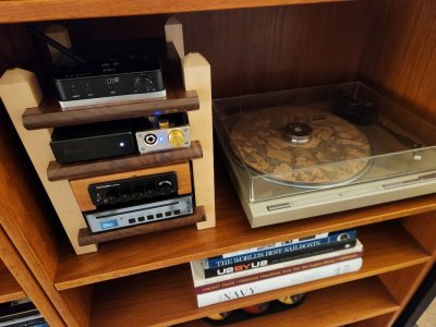

Makes sense, first I need to try the move, wanted to yesterday but other things got in my way.
Okay decided to test quickly before heading to the office:
- Kept CD transport off and moved it over to the right on top of my TT.
- Turned BT on my phone off (so it wouldn't automatically connect to my XM-4's
- Powered up the Ultra and selected Wifi input, Pandora and started streaming to my speakers.
- Powered up my XM-4s and nothing auto connected, including the Ultra
- Changed Ultra output from speakers BT and music started playing normally over my XM-4's
- Decided to first move the CD Transport back on top of the Ultra, but still powered off.
- Played 2 songs like this w/o any issue
- Then grabbed a CD, powered on the CD transport, inserted CD and pressed play. No change to audio streaming quality at this point.
- Stepped back about 10 ft and listened to several songs, and nada, all good. Hummm...
- Finally decided to connect my phone to the XM-4s at same time and so I did. Still good streaming on current song.
- Finished current song and next song started and that was good.
- But the following song the issue started happening.
- I then disconnected BT from the phone while the streaming issue was happening and that had no change.
- Listened some more, even advanced tracks but still each track was having the streaming issue.
- I took off my XM-4's which pauses music, and worked on something else for a few mins.
- I came back and put my XM-4's back on the the music was streaming good.
- I picked up my phone and unlocked it and the screen had that pop up on it again "Unable to start scan. There is an issue while requesting to start a BLE scan. Please restart yoiur phone to resolve the issue. We're very sorry for this inconvenience."
- There's an OK to clear this message, and note again BT radio is off on my phone at this stage.
- Then about 5 mins later while my phone is still just sitting on my desk unlocked with BT radio still off, the message appears again. No effect in current streaming to my XM-4s so I click OK again. I'm assuming it will keep coming? I wonder if this is coming from the WiiM app code stack with android? @Wiimer ??? **Update, it must be coming from the WiiM app because the app is greyed out in the BG and I have to click OK to get back to the WiiM app.
Now, I'm putting more weight on having my XM-4's connected to the Ultra AND my phone more than the CD transport?
Right now I'm going to start a longer-winded session with my CD transport playing a CD while streaming Pandora to my XM-4s from the WiiM only (not other XM-4 BT connections, including my phone). I'll reply back later
Roy
Uggg, why am I not able to corelate anything causing this? I just listened to 6 or so songs with my CD transport playing a CD and my XM-4's only connected to the Ultra. Albeit, the app on my phone keeps throwing that popup about BLE every 5 mins while my BT radio is off and I have to click OK. I'm assuming this pop up doesn't happen for other android users of the app when they have their BT radio off?
Then out of nowhere, 7th song, the issue started back. I took my headset off, which pauses, put back on a few mins later and streaming is good again, LOL.
So...
- WiiM to XM-4s via BT and no other connections to the XM-4's with CD Transport on top of Ultra playing a CD, issue happens.
- Same as before but with CD Transport off and moved of to the right of the Ultra, issue happens.
- Same as #1, with XM-4's also connected to my phone via BT, issue happens
- Same as #1 with CD transport on top of Ultra, playing CD and XM-4's connected to the WiiM and my phone at the same time.

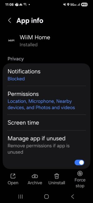

I don't think this is related to this issue, but please check if the 2 permissions in the WiiM app are allowed.
-Location
-Nearby Devices
I would like to point this out again, too. Have you taken this into account?
This has often been recommended, even by Sony itself (see also yesterday's link).
I'm not sure more about the pop-up, so wait for a response from the @WiiM Team.
-Location
-Nearby Devices
They are allowed, see screenshot.

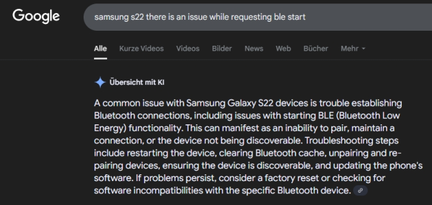

@Zap Rekowski so basically reset the network on my S22, sure I can do this, but I feel it's 100% unrelated to the issue at hand since I can reproduce the issue w/o any BT usage of my S22.
Thank you,
Roy
Yes that's true. I saw your pic, with the message. Maybe helpful to fix this issue: It is only to point out that the S22 is also known for Bluetooth problems and your described problems of the phone could be fixed.
According to some research, the Sony also has its own peculiarities.
Unfortunately, incompatibilities can occur from time to time. I had a Samsung phone that just wouldn't work with my bathroom light (with integrated Bluetooth speaker). All other devices had/have no problems.
I would always research and apply all fixes to all devices concerned.
I think it's admirable what a handstand you're doing, including rearranging the devices, to get it to work. My opinion: It shouldn't be like that. It should work without any problems if there isn't a microwave in your rack...
