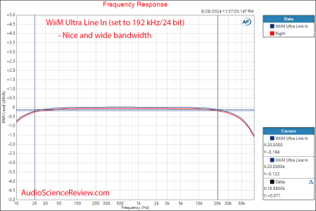

In both my systems nearly everything now goes thru a WiiM. IF a source has content below 20Hz can a WiiM pass it on to the amp?

I'm pretty sure now the WiiM can process & output infrasonic frequencies.
As a quick test I used a function generator app I have on my phone & set a frequency sweep from 1Hz to 20Hz in a 10-second sine sweep. I then Bluetoothed that to the WiiM >> my old PS IV preamp >> Adcom GFA-5800 amp >> Thiel CS7 speakers. These old components output the sweep all the way down to 1Hz. I didn't try to measure any roll-off... Really didn't care... Just wanted to see if there was a lower limit to the WiiM and my system. ✅
