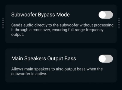

  4. Advanced Subwoofer Controls (requires app version 2.11.7 or later):
    • Subwoofer Bypass Mode: Allows main speakers to output bass even when the subwoofer is active.
    • Full-Range Subwoofer Audio: Sends full-range audio to the subwoofer without applying a crossover

In Subwoofer Bypass mode does the the high pass filter still work on the main speakers? If it did you could use the Sub lpf at a different frequency from the high pass.
I have not tried this yet, but yes, I believe so. Thus, there is a separate switch for the main speakers to output full range.
Hi Slartibartfast,
Two options are now available for the Subwoofer: 1. Subwoofer Bypass Mode 2. Main Speakers Output Bass. Please review the output frequency settings for both the Subwoofer and Main Speakers:
#1
Subwoofer Bypass Mode: On
Main Speakers Output Bass: Off
The subwoofer will output full-range frequency audio, while the main speakers will output audio frequencies above the crossover frequency.
#2
Main Speakers Output Bass: On
Both the subwoofer and main speakers will output full-range frequency audio.
#3
Subwoofer Bypass Mode: Off
The subwoofer will output only audio at the crossover frequency, while the main speakers will output full-range frequency audio.
#4
The subwoofer will output only audio at the crossover frequency, and the main speakers will output audio frequencies above the crossover frequency.

You could increase the sub out to a somewhat higher then normal level and then use a shelf EQ (or RC) to reduce the overall level again. That way the main speakers would only partly support the subwoofer. But this it a bit tricky to dial in.
The biggest advantage of high pass filtering the main speakers is to reduce the thermal load and distortion, in particular IMD in the case of typical 2-way speakers. With Main Speakers output Bass: On this is no longer the case, of course. Depending on actual speakers, room size, desired listening level running the mains full range might turn out advantageous at times. In most cases I don't think it does.

There’s new added features on sub section. I’m trying them to see which one I like.
The subwoofer bypass sound tight than having both toggle off. I hope they will include this on ultra with both toggle.
